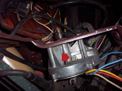

Jo, a ještě lokalizovali ten šroubek na fotce, tak co to prej je zač, asi teda si myslim . . .

Chce nastavit koncový doraz stěračů ( v dolní úvrati ), dočetl se polské škodovácké bibli, že to prej de nějakym šroubkem, tak se ptá, kde ho najde a jak se to nastavuje.
Tak se ukažte, Škodamaniaci!
-> Max Shindler: This should do the trick.
BTW, I've never try to change this . . . you catch up a little bug here, then another shows there and so on . . .

OK with guys form my club we've lokalized (after 2h searching) this screw. It's lokalized above this brass covering the wippers engine. Here is the photo.

Salve Skodamaniacs again!
I have another question to specialists. I would like to regulate the zero line where wipers are stoping (point near the bottom of window). In the bible of Skoda (in Poland we call that a book of Jerzy Jałowiecki "Skoda 105-130") I've read that I can change the working-field of wippers by:
1. moving the arm of wipper (with this i can change the vertical stop point) and,
2. by regulating the bottom stop point by "a screw in the cover of wippers engine".
If looked but I haven't found it. Is this true. Wher is this screw?
Of course we are talking about Skoda 105.
